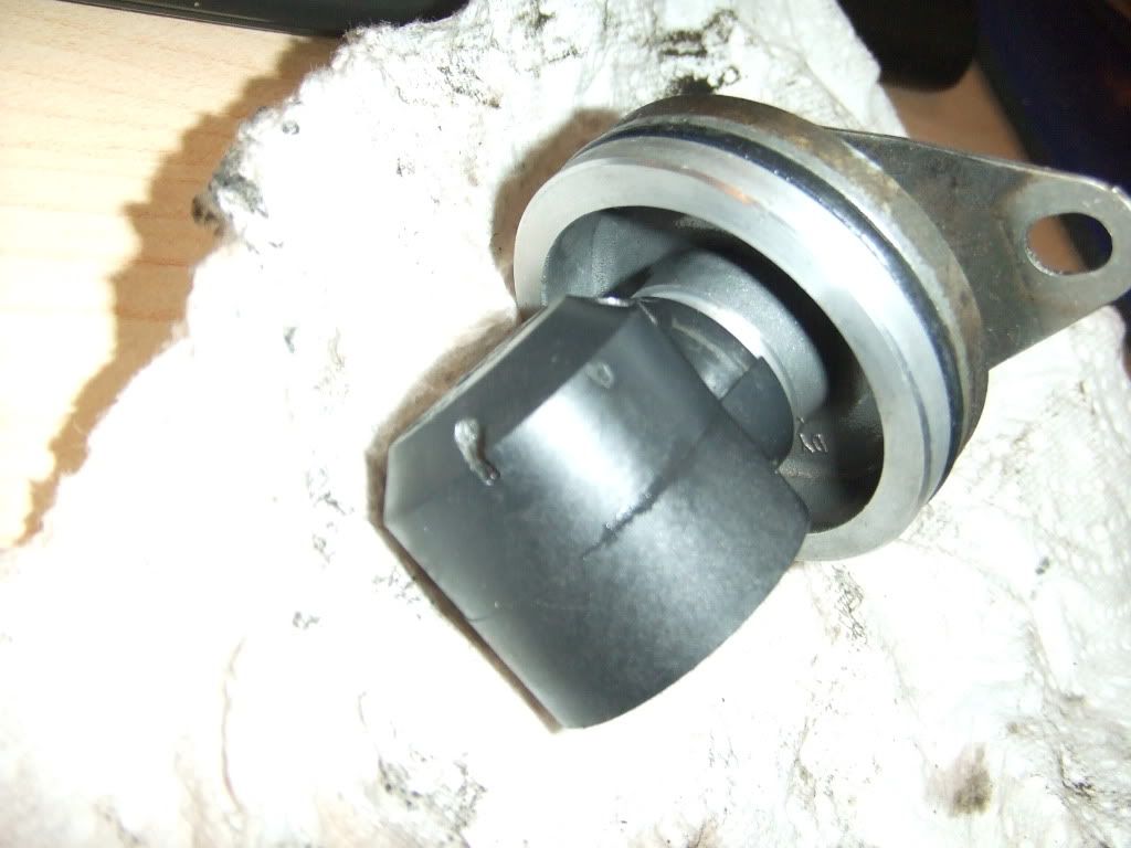

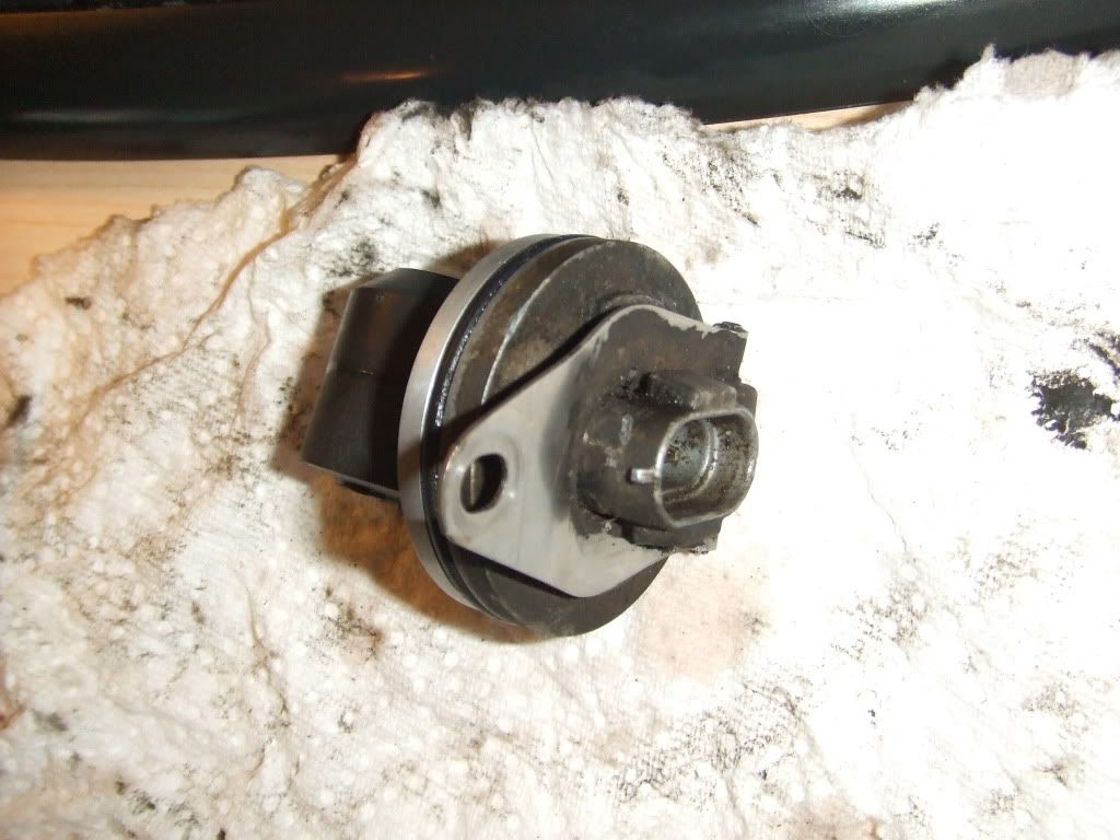

The VSS (vehicle speed sensor) on the transmission is probably the wrong type. Some were optical and some were a magnetic tacho-generator. You should be able to refit the VSS from the original trans (if it's still available) and solve the issue.
The trans is a 4L60, which is a variant of the TH700-R4. If the VSS output is pulsing 100X what it should, the transmission will go into TCC lockup at about 5MPH actual speed.
There are three possible types of VSS signals used by the ECM for various TH700-R4 and 4L60 transmissions:
1. The two-pulse (2000 pulses per mile) square wave D.C (optical) used on all TBI engines thru 1992, all computer-controlled-carbureted engines, and on most 1985-1989 TPI engines.
2. A four-pulse (4000 pulses per mile) sine-wave A.C. (Tacho-generator) required by the 1990-1993 TPI, 1992-1993 LT1 engines, and 1990-1993 Camaro 3.1/3.4 V6 engines.
3. A 40 pulse per driveshaft revolution speed sensor used on 1993 and newer trucks with automatic transmission, 1994 and newer rear drive cars with the automatic transmission

Stamped on the sensor is 8654750 A few photos of the part from the trans I have are below. Is there a replacement sensor that I cna put in this ones place that pulses less? or am I screwed to take the tailshaft off and replace the whole part
I am really confused I can not seem to get a straight answer and I appreciate what I have learned here I have somewhat of a direction now.
Any advice on what to do now would be greatly appreciated cause I have a car on ramps in my driveway that is not mine and I don't want dripping tranny fluid
