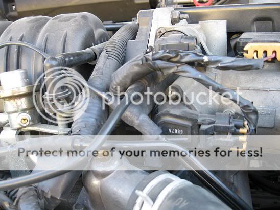

Chris, when you replaced the motor, are you sure you reconnected the trans modulator vacuum line to the right place. The latest description of your problem, sounds like the tranny is "pressure shifting" rather than modulating pressure. Do you have a vacuum digram on your radiator support, similar to the one below? This one is for an L36, but not very clear. The second picture is an actual shot of my L67 vacuum ports (modified) but in original locations. The modulator vacuum line goes to the bottom throttle body port "T" fitting and the other side of the "T" goes to the fuel pressure regulator (FPR). Track yours down & let us know where it is connected. A few pics would help.

I think mine is hooked up right. I saw one rubber piece was cracked, so when I replaced it, I looked at the diagram. I will take a picture.

The vacuum connection appears to be right @ the TB, just be sure the other end goes to the modulator. Have you removed the vacuum line from the modulator and checked for the presence of trans fluid?
