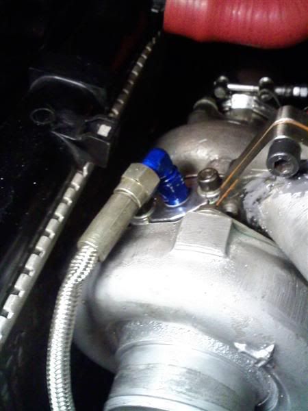

That looks pretty decent. How is the waste tueb going to get ran?
May I make a suggestion... put a 90* fitting on the oil feed line. I have mine the same way, and the hood hit it at some point once, kinked the line, and starved my turbo of oil. The fitting is only like $5, and will save you in the long run. It's a -4an 90* male to female fitting. Just a thought.

Ya I bought a fitting. But it's like the turbo sits so high up, it still hits the hood. I shut the hood and it broke my fitting also. Had to get another one. But can't close hood 100%.

Did you put a 90* fitting on the feed line?

Yup. But it hits the hood.

You can clock the turbo slightly without having oil draining issues. This should fix it if it is barely hitting the hood. Otherwise you might be able to remove that flange adapter thing you got going on and get a screw in fitting, might lower it a little bit also

Ya I have a screw in fitting sitting somewhere I was using before. Thinks it's in my tool box. I'll try to clock it alittle and put the fitting back on and see if that helps.

I'm confused by this. The feed line you have now doesn't hit the hood, but with a 90* fitting on there it does hit the hood? That doesn't make sense. The 90* fittings are tiny
This was how mine was with my bigger turbo sitting right at the front of the car, and it cleared perfectly and then some. I don't understand why a 90* on your setup sitting farther back wont close the hood.

The feed line hits the hood also, even without the elbo installed. It's like the turbo is sitting to high up or someting. I got it clock pretty much as far as urs. Scared to go anymore, cause IM not sure the oil will drain good enough.
