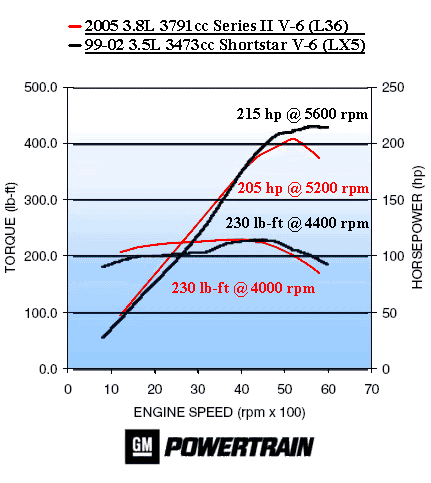

That said, I think Id probably take a 3800. I prefer the powerband of the 3800 for daily driving. The 3800 has a tremendously flatter torque curve and makes nearly the same amount of torque from idle all the way to its peak.
The same cannot be said of the 3.5, somewhere around here theres a dynograph of both engines side by side. Its not that the 3.5 doesnt make good power, just seems to me like you have to drive it a bit more aggressively to get it.

If im a highway driver I'd want the 3.5 I need the passing power and quicker response, I would also prefer the 3.8 if I were mostly a city driver but then I would get the IM gaskets replaced with some better ones. I read on some W-body performance websites that if you buy their UIM Gaskets for the 3.8 it will give you more flow more power. When I brought my intrigue I thought that since this car was built on its 3rd year they worked all the bugs out or most of them. The first 2 years may have had some problems with electrical, chassis, 99 3.5 heads that fail rockers? and some more things. For me again I'd say if you have the money make your own Intrigue get a nice body put in the 3.8SC with HD Trans, do atleast 18inch wheels and tires, full suspension, Brakes Front and rear GXP, get a GLS. Also some power mods. Now this would make a awesome Intrigue but is it worth it?

http://i357.photobucket.com/albums/oo15/bmwmperor/The%20Forums/lx5andl36.gif
Also take note that the 98-99 Intrigue 3.8s were rated at 195hp and 220tq and in the 99 owners manual they rated the 3.5 215hp at 5500rpm and 234tq.
