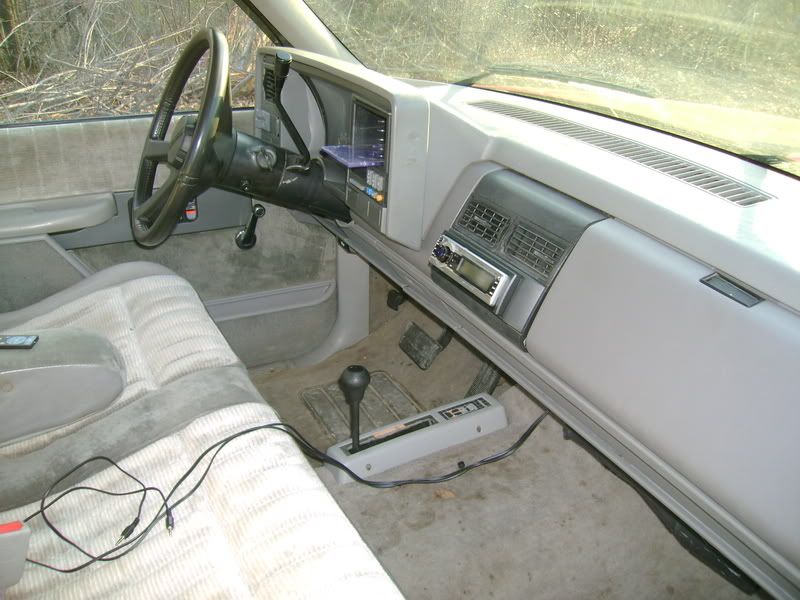

heavymetalmachine
05-26-2010, 06:21 PM
+3 on Crutchfield...
They give you everything you need!!!
Not that mine was fancy but just as a reference....
http://i139.photobucket.com/albums/q301/southbound_bucket/1992%20k1500/DSC01412.jpg
