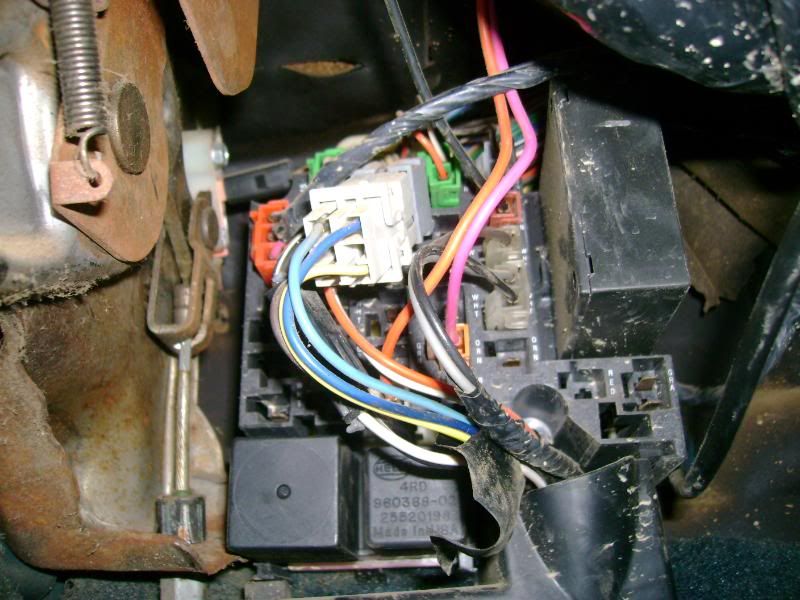

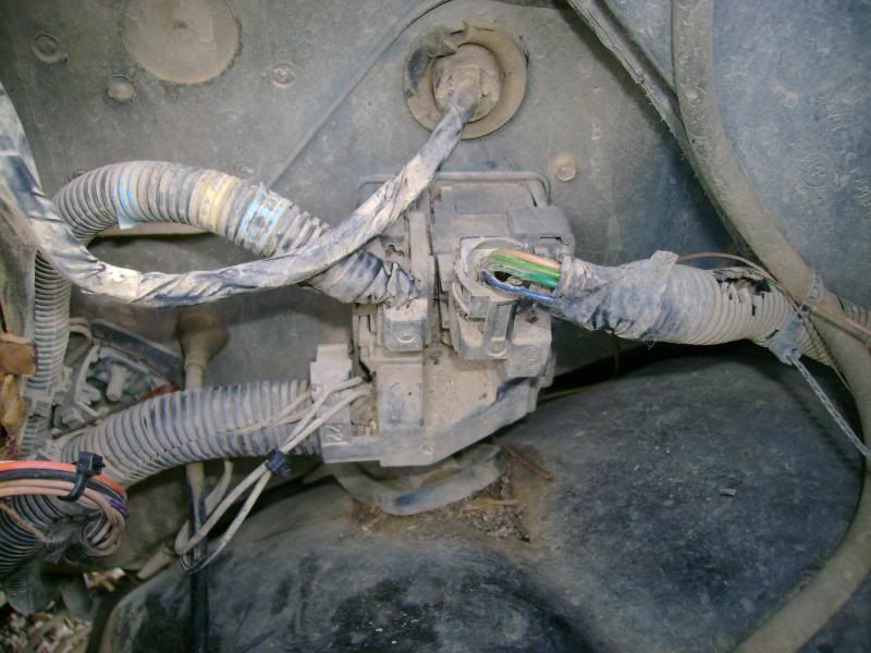

Ok here goes trouble with passenger side rear taillight..Light comes on with head lights and parking light just fine..No hazards no turn signal and no brake light..So I redid the ground no help. Swapped taillights from another truck no change.. The way it was acting I was sure it needed a new board so I replaced it this morning and still no go...So I got out the test light and tested just after the rear plug and no power to the green wires.. So I went and tested before the splice for the plug in the bed for the goose neck.No power..Now I check at the plug under the hood at the firewall and no power..I the tested at the plug at the bottom of the steering column and found power..Green wire blinks on and off...
So what I want to do is test power to the terminal that the harness under the hood plugs into but I can't seem to figure out how the clip is held on..

Also how do I remove this if need be???

Sorry but thanks I got them working....
heavymetalmachine
05-15-2010, 06:54 AM
It was my almost new blaupunkt London Head unit..
I had it in my 92 and I use the adapter kit for the wires so I thought it should be plug and play...Never crossed my mind it was bad..Till I got bent and started unplugging everything and when I pulled the plug on it the light in the test light went out..Stepped on the brake pedal and both lit up so I run the blinkers and they all worked too...
