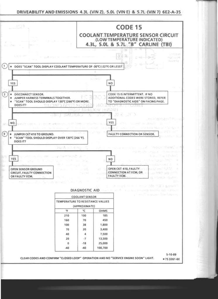

05-02-2010, 01:02 PM
Code 15 is a coolant temp sensor circuit.
Sounds like you have multiple problems.
Hope this helps
http://i819.photobucket.com/albums/zz116/amm9260/code15.jpg?t=1272823121

Blue Bowtie
05-06-2010, 10:04 PM
You can test the resistance of the sensor and compare it to the approximate temperature range:
http://www.thirdgen.org/vader/CTSMAT.jpg
