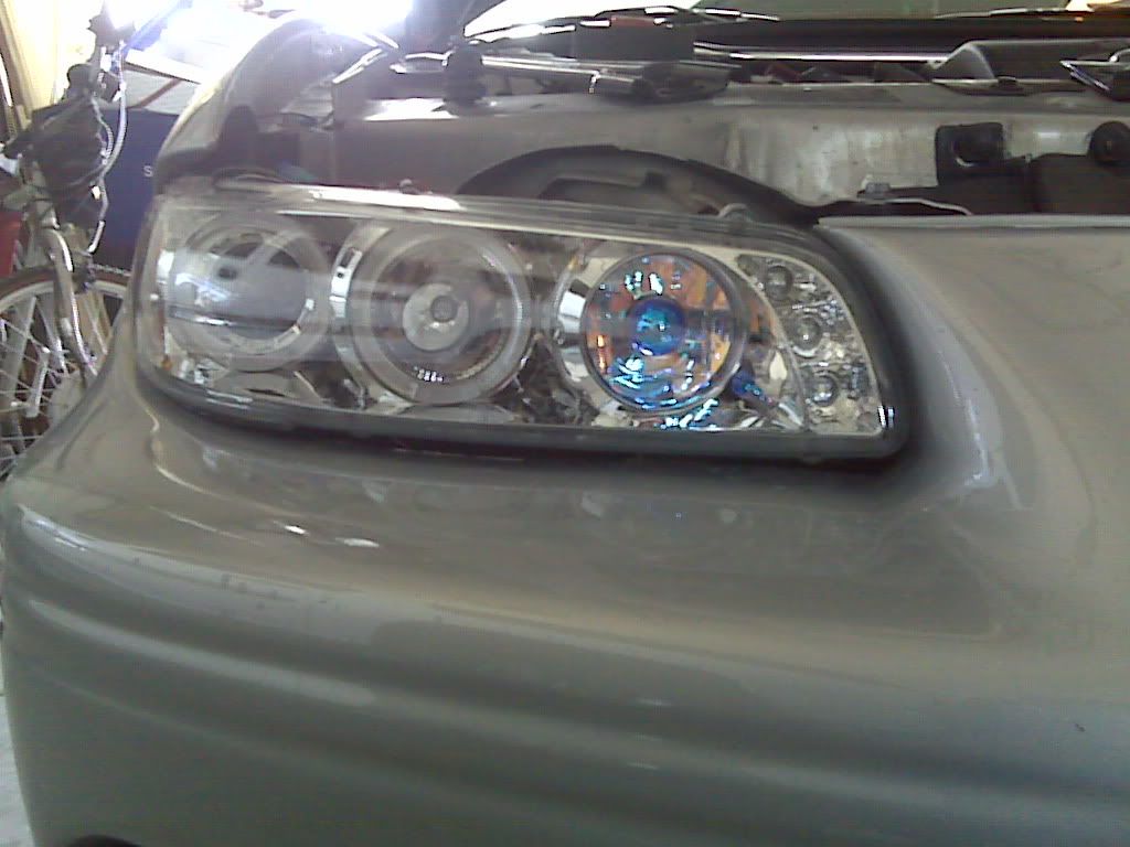

Since the driver headlight had to be replaced anyway I thought it'd be a good time to upgrade so I got some projectors and HID's and the insurance paid just over half of it! :iceslolanhttp://i286.photobucket.com/albums/ll90/Mattman_2000/Car%20Pics/IMG00631.jpg
http://i286.photobucket.com/albums/ll90/Mattman_2000/Car%20Pics/IMG00632.jpg
I don't have pics of them on yet, but it's pretty sweet I think. I killed the DRL's so I don't waste all my HID life and then wired up the halos and LED's to a relay and those act as my DRL's. I love it.

hows the cutoff line on those headlights? I've heard several mixed emotions about those ones.
also...when you unlock/lock your doors, do your headlights blink? If so...you're gonna wanna change that asap
00GTP4ME
07-28-2010, 09:07 PM
Thanks guys and yes I was worried.
Nope the headlights don't blink fortunately! Just the parking lights. :D
The cut-off is fantastic. It's a VERY well defined line and it doesn't really bleed at all. So far I'm loving these lights and no one has brighted me or anything.
