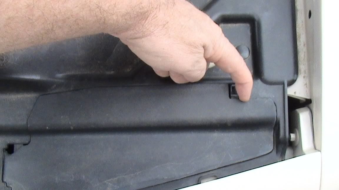

REMOVE ONE SCREW NEAR THE LINCOLN EMBLEM...
OPEN THE ACCESS COVER:

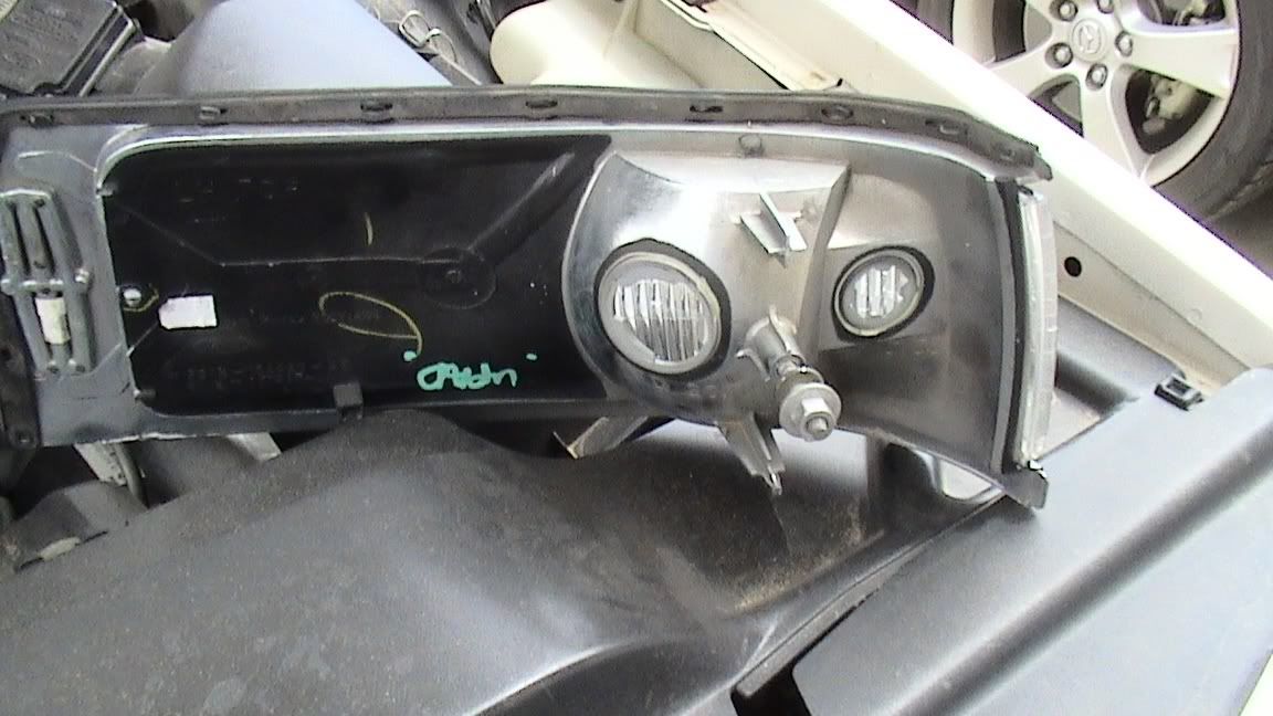

LOCATE THE #1 NUT and REMOVE IT:
http://i191.photobucket.com/albums/z51/sdhartney/96CnrLmp02.jpg

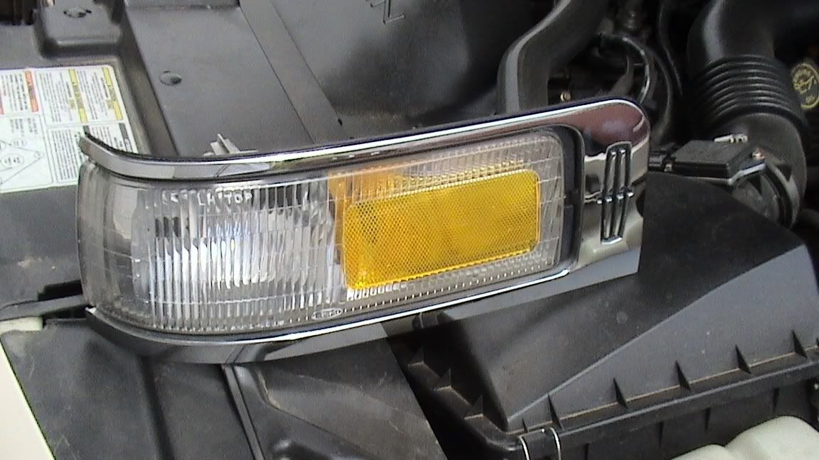

REMOVE THE LAMP ASSY AND TAKE PICTURES FOR THE FORUM:
http://i191.photobucket.com/albums/z51/sdhartney/96CnrLmp03.jpg
http://i191.photobucket.com/albums/z51/sdhartney/96CnrLmp04.jpg

Could they have made any less room to remove that damn 7/16 nut or what?

The difficulty level was only present due to not being able to get much movement on the nut once you got a box wrench around it; a small box wrench at that. But it did come off easily by hand once broken free. Same when tightening, just a few difficult turns to secure. I don't think removal of any more plastic panels would have helped.
