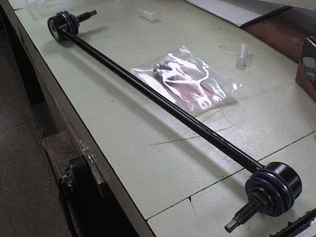

richtazz
03-29-2010, 12:02 PM
Since AC-Delco doesn't have a picture of this part on their website, I took a picture with my camera phone of what this part is supposed to look like. The part off the OP's car is obviously severly damaged. AC-Delco part number 45G20592 (GM# 19187114). Front stabilizer link, fits 04-08 G/Prix's.
http://i44.photobucket.com/albums/f44/richtazz/car%20parts/04-08GPlink.jpg
