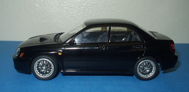

These wheels were done the same way; Spray TS17 Aluminum, then brushpaint the spokes w/ X10 Gunmetal.
