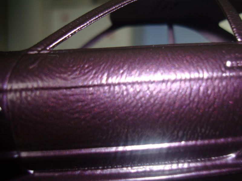

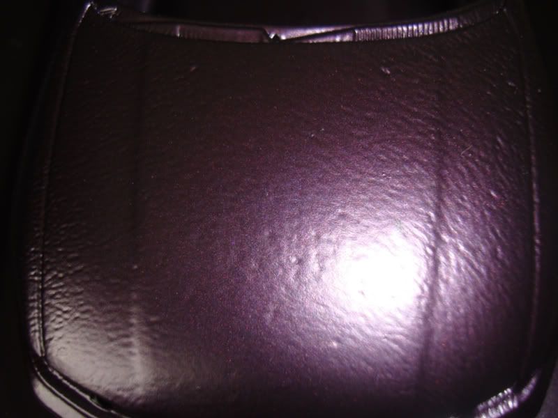

Hi all.
Model is a Tamiya R33 GTR Vspec.
The model was lightly sanded with 800 grade wet / dry sand paper.
Then washed in warm soapy water and left to dry.
I applied a very light coat of Tamiya Plastic Primer, then after that dried sprayed another light coat, but slightly heavier.
After that dried, I added another 2 coats of primer, not too thick, but it looked spot on after I had finished it.
I left the model to dry in a food container, with the lid on and a small hole in the bottom for 24 hours. ( that was yesterday)
Today, roughly 24 hours later, I lightly sanded the primer with 2000 grade sand paper and washed it again left to dry.
The paint is Zero-Paints Midnight Purple LP2.
Air brush is just a cheap hobby one, nothing special, but its good for a beginner with air brushes.
I sprayed a very light coat of the paint and gave it time to dry and then sprayed another light coat of paint, still could see a little primer through the paint.
After that dried, I gave it another coat and noticed the paint look funny.
It felt rough too.
After it had dried, I wet sanded it with some 1200 grade sand paper and let it dry off, then started airbrushing again.
The bonnet and roof where I spend most of the time sanding look better, But everywhere else looks the same.
I'm wondering weather this is what you call shrinking effect with the primer?
I've used food containers with this model to try and keep dust out of the paint work, with just a small hole in the bottom.
http://i25.photobucket.com/albums/c62/Jasoncmor/DSC00891.jpg
http://i25.photobucket.com/albums/c62/Jasoncmor/DSC00890.jpg
I need help.
I don't know what this problem is?
Thanks

Looks like you need thinner.

If the paint looks rough and pebbly when you're applying it, it's too thick, and it won't smooth out as it dries. Don't worry about coverage; thinner paint will cover just fine.
