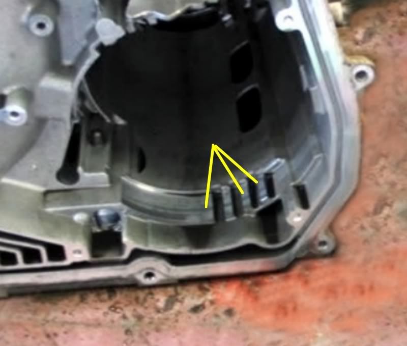

Here is a pic , this is an 03' with the updated Valve body.
Housing & gears (http://i28.photobucket.com/albums/c242/xeroinfinity/Transmission/45eshaft-housing.jpg) Limited Slip differential (LSD) driver gears and shaft are still intact.
This is what I am rebuilding, the 99' had groves and scratches (http://i28.photobucket.com/albums/c242/xeroinfinity/Transmission/housingscratches.jpg) that were not repairable.

xeroinfinity
05-25-2007, 04:29 PM
Bump on this (http://i28.photobucket.com/albums/c242/xeroinfinity/Transmission/2EPRevEd.jpg)one time :ylsuper:
Or two times :evillol:
I was concered at first because it looked different then the one on thier site.
So I called them and I guess this is the updated version.
I tried cleaning most of the cheap paint off those springs...
Kinda stupid even painting them,
that crap does not need to be in my pricey transmssion floating around :grinno:
I should have this thang all together this time tomorrow :evillol:
Any questions or comment post away!

xeroinfinity
05-26-2007, 12:03 AM
It is pretty :D
Now its coverd in red assembly lube.
I Started soaking my clutches today, should be ready to put together by tomorrow. Hoping I can getter done in a day, might be a long one .....
Not sure when I'll swap the tranys out but soon :D
btw you see I scribed "XI" on the case :lol:

xeroinfinity
05-26-2007, 07:55 PM
No not always, but when it cost $650 damtootin :p
I wished I could make my own instead :crying:
I Did get everything together today, only took 6 hrs..
It seems tight when I engauge/turned the shafts, must be the new clutches and heavy differential :grinyes:
Still not sure when I'll put it in the SE .......

xeroinfinity
05-30-2007, 07:34 PM
Something else I forgot to mention was the chain drive.
I just used the stock size gears & chain - 7/8" ,
which was replaced with NEW parts also.
