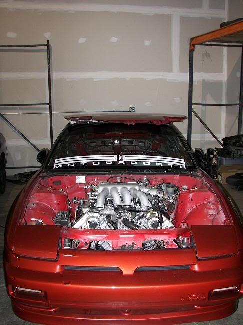

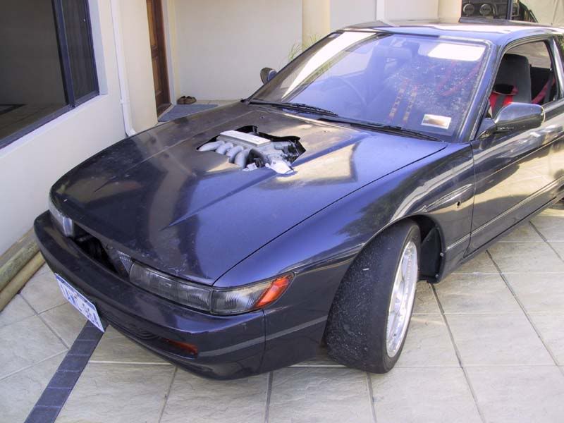

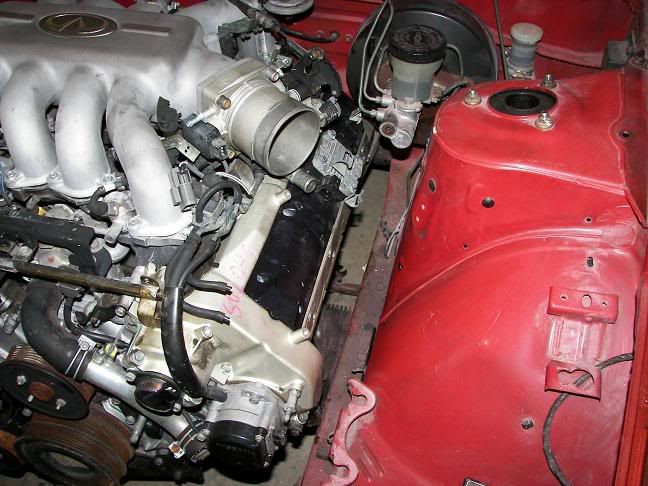

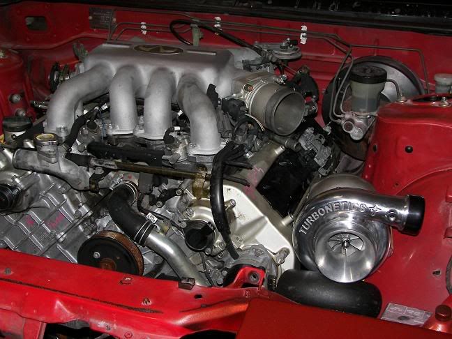

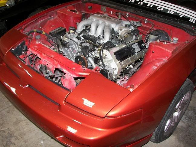

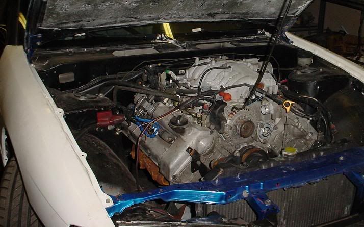

check this out http://www.automotiveforums.com/vbulletin/showthread.php?t=595634
http://i13.photobucket.com/albums/a293/moparcharger450/vh45j.jpg
http://i13.photobucket.com/albums/a293/moparcharger450/vh45h.jpg
http://i13.photobucket.com/albums/a293/moparcharger450/vh45g.jpg
http://i13.photobucket.com/albums/a293/moparcharger450/vh45f.jpg
http://i13.photobucket.com/albums/a293/moparcharger450/Fancy4.jpg
http://i13.photobucket.com/albums/a293/moparcharger450/DSC02525sm.jpg
http://i13.photobucket.com/albums/a293/moparcharger450/Detail1.jpg
http://i13.photobucket.com/albums/a293/moparcharger450/v8.jpg

In the linked thread, the original poster asked how the VH compared to the RB in terms of weight. Well, the aluminum block VH compares pretty favorably. They weigh a little over 500lbs(~521lbs). That is only a little more than the iron block KA(~493lbs) and probably quite a bit less than also iron block RB(possibly ~700lbs or more).
The weakest VH, the 4.1L version, still makes 266hp or something. That's a pretty good power gain right away. There's always the option of some sort of build, whether it be NA or FI.

Wow cool swap how hard is it to get the mounting hardware for the V8? Does it bolt up to the stock tranny? I wounder how it would compare to the LS1/LS2 swaps. DOHC vs 5.7/6.0L displacement. The LS series engines are lighter (aprox 380lbs for the LS2 about a hundred lbs lighter than the ka24) but you cannot beat the high RPM breathing of DOHC. For me it would all come down to which was easier to swap.
MetalHeadZaid
08-29-2006, 06:15 PM
the vh45 will need the vg30 flywheel, clutch and tansmission. then you need a custom driveshaft, mounts, ect. i hear theres a kit coming out for LS swaps so that would probably be easyer, and its alot cheaper to make power out of an LS engine, but i would never go with anything but the VH
