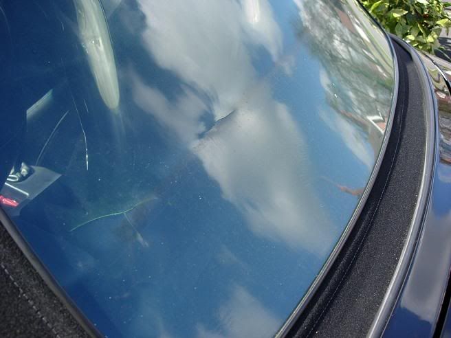

So after getting a few quotes for fitting a rear screen, I decided to take on the challenge and show you how I fitted mine, or should I say Claires
First of all I gave it a bit of a wash,
just a quick one on the drive way, Now to show you the reason why it needed changing
