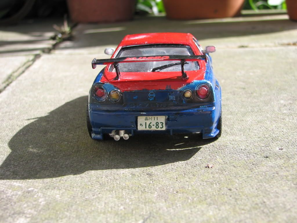

my skyline z tune which i rebuilt tell me what you think comments and critism welcome right here we go

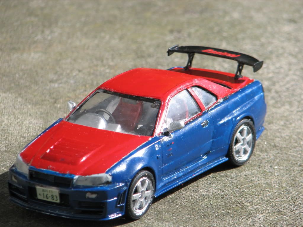

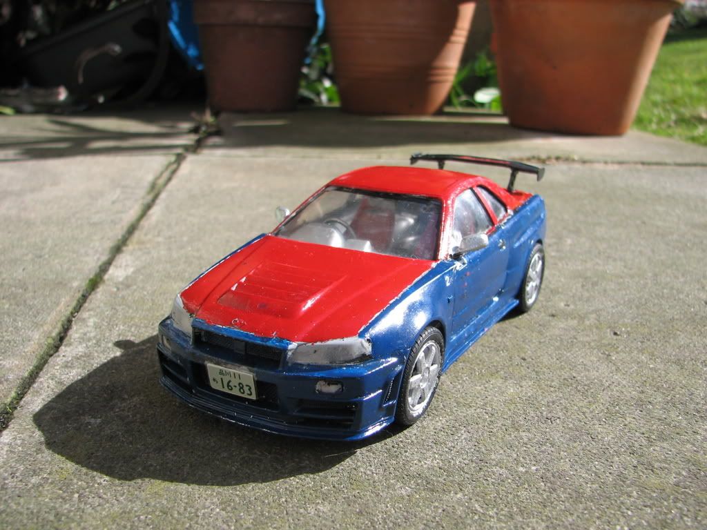

It's quite evident to me that you hand-painted on the paint with a brush. A few tips I can offer are:
1). (Most important) Take your time - Think through what you're going to be painting eg. it looks like you've painted the wheels with the tyres on because you've gone over onto the tyre in some places. Paint the rim first, then once it's dry to handle, then put on the tyres. Even if you're handpainting, take time getting your edges perfect (side windows & boot lid). You could have touched up any mistakes.
2). Use spray cans or an airbrush to apply paint. Small pieces like in the interior can be hand-painted. Along with this is to use good quality masking tape. You'll achieve much better coats of paint and definition of your lines if you're going to do two-tone. If you can't buy Tamiya TS-range paints, try your local Halfords but always remember to use plastic primer first.
3). Don't touch the clear parts of the kit until you really have to. Paint the body first and once you're happy with it, then apply the clear parts of the kit. Don't use the same glue (plastic cement) as you've used for your body parts. Find a good white glue as they dry without fumes & clear.
Also, from what I can see, don't apply the metal transfer decals until after the paint. It seems you've painted over yours. If they were there before (you said rebuild) then use a high grade of abrasive paper (MicroMesh polishing pads/Halfords wet & dry paper etc) and gentle polish the metal until the paint comes off.
A lot of information is found in the FAQ: http://www.automotiveforums.com/vbul...ad.php?t=63623 which you should read. Looking more and more at your build, I'm starting to like the two-tone scheme....I'm normally not a fan but yours is growing on me. Really looking forward to seeing your future builds and progression. Best of luck
