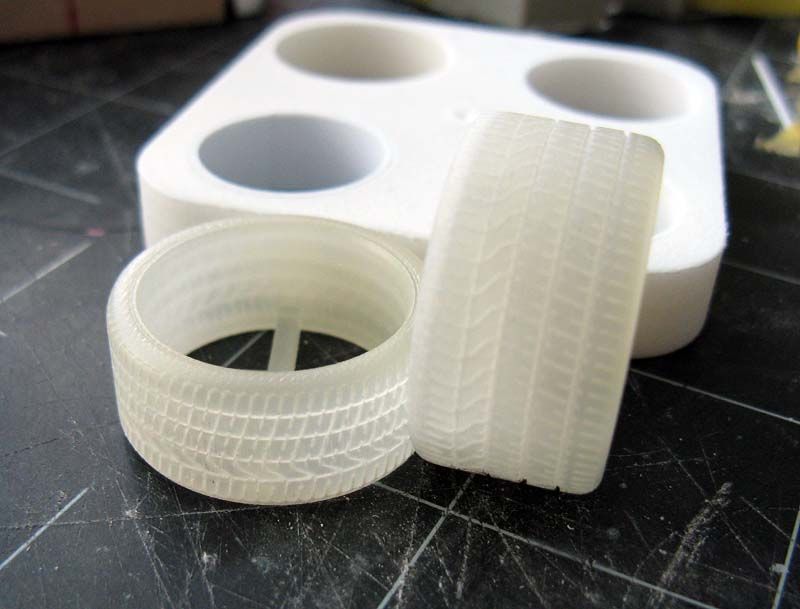

As requested in the completed B2 thread, here's a brief WIP.
This project is almost entirely scratchbuilt. "Almost" because tires were 3D-printed and copied in urethane rubber.
I thought of making tires myself, but I couldn't get fine tip scribers (like 0.1, 0.15 mm) because of limited time and budget.
