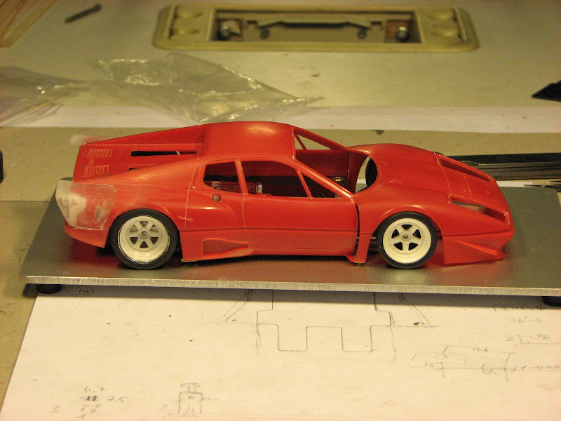

So I had to do all the modifications on the kit..but as we would also race it, it meant that I could not use any filler
or putty as these would crack and chip of the body the first time it would hit the boarding or an other car !!!
After more headbanging and trying to avoid the subject in the end I just had to take a deep breath and cut off the rear spoiler.
Then I took the Dremel and milled ± 1mm of the rear fenders. This to create a reccesed area to which I could glue
1mm thick lexan sheet that I bent to shape with the aid of a hair dryer.
Here the absurd thickness of the body actually helped as there was still 2mm of material left to glue the lexan to.
The secret of performing this job without any filler is to test fit both the lexan and milled recess over and over again
so you get an almost seemless fit. There were needed I filled the remaining gaps with Zapp thick CA or the thin CA in combination
with glassbubbles.
Above the result after a lot off sanding and two shots of paint. This process would repeat it self many more times during the build.

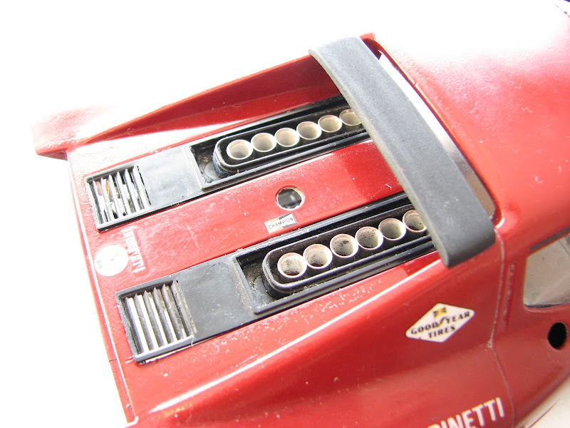

Next item on the list were the intake trumpets. We actually made these form cable end caps, their dead cheap and a lot lighter than
the machined sakatsu parts. It was still a racecar and every gram would count.
The Fujimi kit had some nice open grills and besides the top covers for the intakes also the undelaying trumpet covers.
I glued the top covers upside down on to the undersides of the grill. Milled the trumpet covers so I just had the rim left
and drilled 2 x 6 holes for the trumpets. I had to do a bit of guesswork here as detailed photo's of this area could not be found.

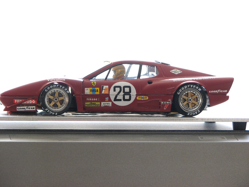

And then it was time to start the race, or first qualifying, and when the flag drops...the bullshit stops.
On new fresh tyres the little Ferrari drove like a dream, claimed pole position and at the start took off...
...showed the whole grid her pretty ass and never looked back.
She may not have been completely correct, but at least in 1/24 scale s/n 18139 did what it had never been able to do in real life......
.....it beat the crap out of the Porsches 935 and won the race.
