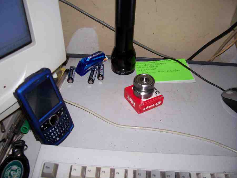

Can one purchase the idler for a Buick without the tension arm? It seems that most of what I've seen are complete assemblies, but I'm not certain since I keep a small supply of 202- and 203-PP bearings on hand for pumps and motors, and they just happen to fit tensioners, idlers, alternators, etc. $4.50 is a cheap fix, and faster than running for parts.
http://www.wwdsltd.com/files/203Bearings.jpg
