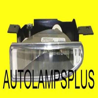

Yeah I've seen those on EBay. See pic below. From what I can see it should have the mounting bracket integral with the fog lamps. The bracket is secured to the bumper reinforcement area by at least two screws/bolts. Best thing to do is remove the plastic splash guard underneath and do a visual inspection. See if the mounting holes are there. PITA the way they are mounted.

BNaylor is correct. Those fog lamps should work fine. They should have the brackets on them already. I've never purchased those foglamps, but I can tell
you that I've repaired the fogs on my car (condensation problem). They are a PITA. Just below the bumper there are 2 plastic guards where the lights are to be inserted. Remove the guards and you should see 2 bolts protruding downward. Your going to need a 9mm or 10mm extended socket driver to remove and tighten the 4 bolts ( 2 on each side ). Good luck.
