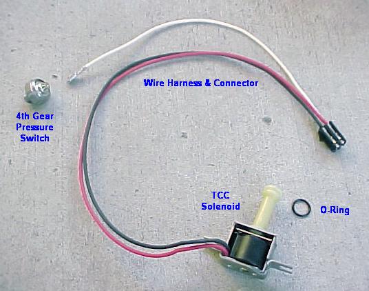

Quick question, does this sound like the correct part?
Sorry I can't provide a picture, we're moving in two days and I packed the camera.:banghead:
Oreilly's seemed to be at a loss on a Torque Converter Clutch solenoid.
The part they sold me was a Transmition control solenoid.
It's T shaped with what looks like wrapped copper inside a housing at the top, with a 2 inch white stem that gets wider at it's end with an O-Ring at the tip, making the bottom of the T shape.
It has two leads and two mounting brackets at the top on either side of the housing.
silicon212
04-26-2007, 12:24 AM
http://www.silicon212.org/TCC_Solenoid.jpg
The image above is for a TH2004R, but you get the point.
MilitantPotato
04-26-2007, 09:39 AM
That's the stuff, thanks! :bigthumb:
MilitantPotato
05-04-2007, 07:20 PM
So far, so good. I've yet to do any long trips, but from the 20 miles I did yesterday all seems well. Thanks again!
