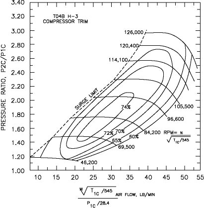

goal: street/strip/ highway run-top end pulls
which turbo would you choose of the two and why?
Turbonetics T04B H3
Turbonetics T04B 62-1
here are some maps

Skewed to same resolution:
http://www.importatlanta.com/upload/files/299/62-1.jpg
http://www.importatlanta.com/upload/files/299/h3.jpg

It just looks like one will favor higher rpm than the other.
Can you plug in your rpm and boost range that you want?

running it through my turbo calculator (making some assumptions of the VE of the motor) the 62-1 has the same peak boost capability of the H3, the main difference is, the 62 spools 2000 RPM's faster, and is *slightly* less efficient in the higher RPM's. But its not major.
If your VE is a lot lower than my assumptions though, the 62 will be into the surge line at higher boost. As with any turbo estimate, it is only a rough figure, and doesn't take into consideration the AR and volume of the housings. But as it stands, I'd go with the 62-1

62-1 looks to be the better choice both when it comes to driveability and power. But I can't sy anything specific since it depends on the application.
