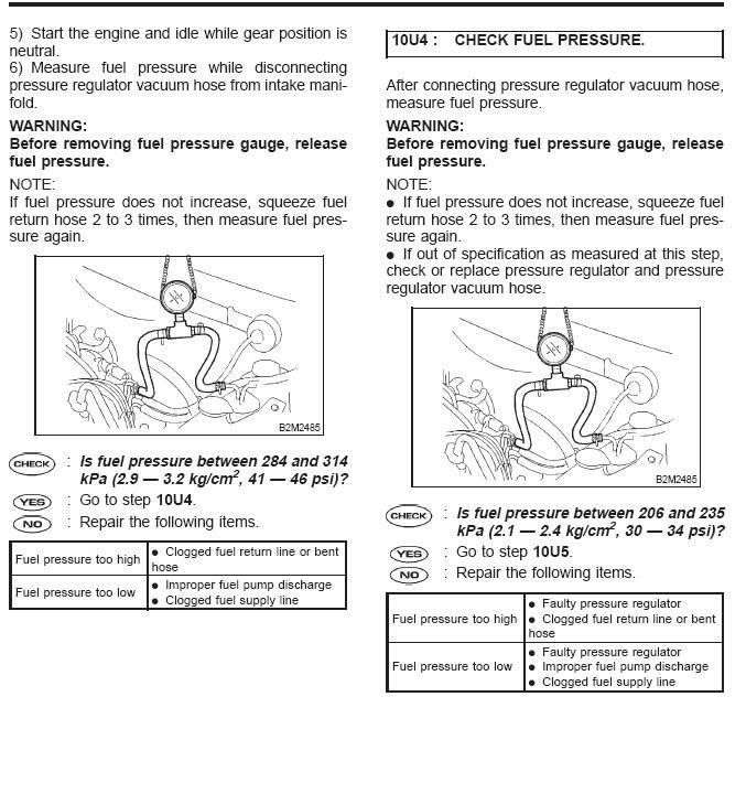

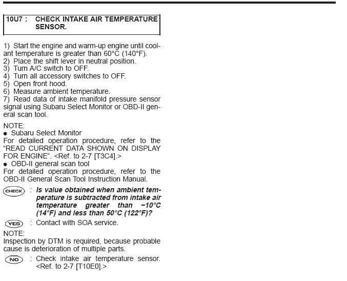

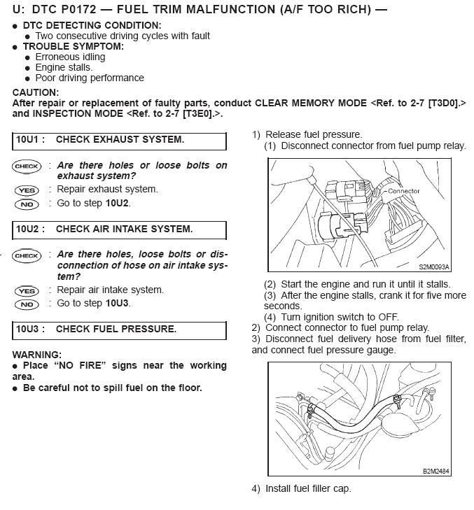

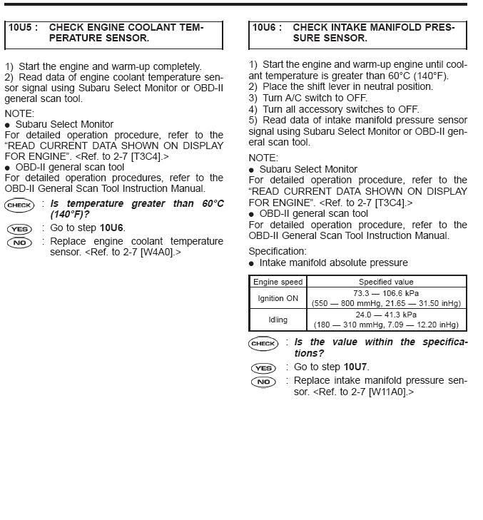

From the service manual, General Diagnostics chapter, the first things to check for when you have 'Poor Acceleration' are:
Intake manifold pressure sensor
Intake air temp sensor
Intake air temp and pressure sensor
Throttle position sensor
Fuel injection parts
Fuel pump and fuel pump relay
Engine coolant temp sensor
Crankshaft position sensor
Camshaft position sensor
A/C switch and A/C cut relay
Engine torque control signal circuit
Ignition parts

Well, I am "My Own Mechanic." I do a lot of research before I DIY. The C.E. code is P0172 (Mixture too rich).

Unless you wanted to check the coolant temp sensor in the meanst.

Got the images to appear down below!

Actually....I finally got the tags to work...woot. If they dont show up for you shoot me a PM and I'll attach them in an email.
http://i126.photobucket.com/albums/p97/Smacksube/P0172%20Code%20Pages/Page1.jpg
http://i126.photobucket.com/albums/p97/Smacksube/P0172%20Code%20Pages/Page2.jpg
http://i126.photobucket.com/albums/p97/Smacksube/P0172%20Code%20Pages/Page3.jpg
http://i126.photobucket.com/albums/p97/Smacksube/P0172%20Code%20Pages/Page4.jpg
