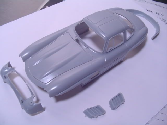

Hello everyone, although I always share my build ups with local modelers via private emails, this is gonna be the first time I share something like this on the web, so, any one here that want to advice me on anything to improve the model or anything you guys think it's not correct, please feel to tell me.
Ok, first of all, this kind of model it's not easy to find except for the 1/25 AMT version. I was so lucky that after mess up an original Heller kit from the 70's, I got another three, the Heller from 1989, the "Prestige" series kit from AMT, and the rare version from Italeri. I think the most complete for the buck it's the AMT, but, to me after finished it looks to me more to a toy than anything else. The Heller version(both are the same, just the art box changes) it's very accurate, but, tooling it's too 70's and some extra work have to be done, specially when you have to glue the two halves that makes the front of the model. For me the Italeri has the most of avantages, starting with the idea that I built the cabrio version last year(some of you guys that went to the 2005 GSL saw it), and it's the same model with the only difference this one has a top and another dash. Also it has more room to any alteration I like to do. The only "dislike" I can mention on this model it's the subject that if it's named 'Gullwing" it's supposed to have gullwing opened style doors, and this one doesn't have them open, but....the makers of this model looks like though on it and engrave wide lines on the body panels and interior detail on doors inside panel were ready for it. So....I picked up the Italeri. I kept the other two versions, the Heller and the AMT, if some one are interesed on them, just tell me and I will sell them.
The AMT "Pretige" Series Kit
http://i7.photobucket.com/albums/y288/Porsnatic/38_1_b.jpg
The Heller-Humbrol Version
http://i7.photobucket.com/albums/y288/Porsnatic/gda23.jpg
The Italeri Version
http://i7.photobucket.com/albums/y288/Porsnatic/9c_1_b.jpg
Simón Rivera
The Italeri Version
Simón Rivera
Porsnatic
08-08-2006, 11:41 PM

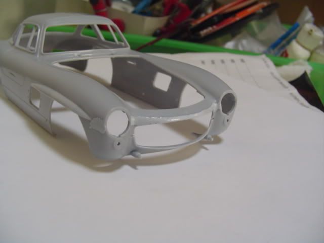

The body building it's quite similar on this Italeri Euro models You have to put together the body that usually it's made out of 3 parts, main body, front half, and rear bottom half. It also will include 2 inside body panels at the sides.
http://i7.photobucket.com/albums/y288/Porsnatic/Picture044.jpg
http://i7.photobucket.com/albums/y288/Porsnatic/Picture046.jpg
Both rear and from sections were glued to form a straight solid body.The inside were sealed with a good dose of super glue. Instead of putty, I treated the seal lines with Gunze Sangyo's Mr Surfacer 500, a liquid semi-thick primer that also doubles as liquid putty. This kind of primer from Gunze it's so great, that you don't have to sand anything else after it dries...highly recomended!
http://i7.photobucket.com/albums/y288/Porsnatic/Picture061.jpg
http://i7.photobucket.com/albums/y288/Porsnatic/Picture064.jpg
http://i7.photobucket.com/albums/y288/Porsnatic/Picture067.jpg
After the primer-Putty was dry, proceed to open the doors. It already started to looks like the gullwing.
http://i7.photobucket.com/albums/y288/Porsnatic/Picture072.jpg
Everything was sealed with my favorite primer, Gunze Sangyo Mr. Surfacer 1000. Contrary to the Surfacer 500, this one it's pretty thinn, but, like the other, no sannding after drying time. You can see the flush and even surface on the model.
http://i7.photobucket.com/albums/y288/Porsnatic/Picture090.jpg
Because I glued panels or like when you shave any detail on a body, chances are that you can see "Ghost images" after the paint coats are shooted, not like with the primer coats. To avoid that, I airbrushed those glued spots with Dupont Variprime to seal everything up. This one just requires a little sanding like the moon mud primer from Cobra Colors, for those that are familiar with the product like my good friend Imaelg.
http://i7.photobucket.com/albums/y288/Porsnatic/Picture098.jpg
http://i7.photobucket.com/albums/y288/Porsnatic/Picture099.jpg
http://i7.photobucket.com/albums/y288/Porsnatic/Picture100.jpg
Everything was again sealed with Mr. Surfacer 1000.

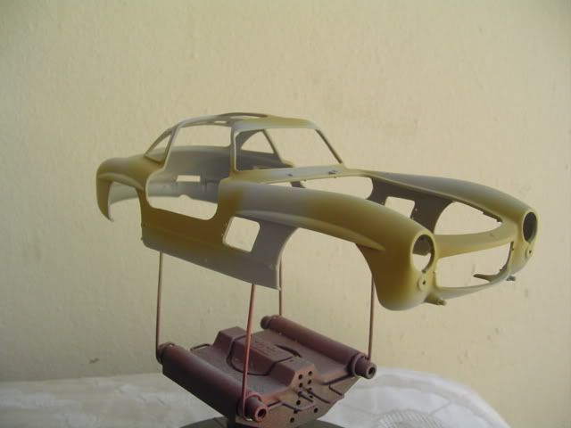

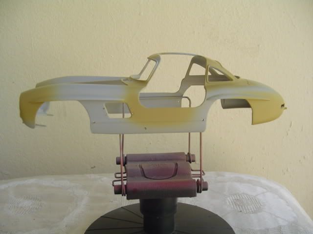

Due to I've been very deep with Finishers paints with my ferraris and any red color model I 've been painting in the last 2 years, I have read that they make a color named Foudation Blue, that is specially designed as a base for metallic color like silver. This blue, makes silver looks more metallic as I read from the Finisher description color list. Due I didn't have on have this blue at the moment I paint my model, instead, I used an old mix of light blue from model masters paints that I did to paint a Porsche 917LH like 8 years ago, It was so much time ago that I thought I can't use but for my surprize, it was in great shape. I just add a little bit of Krylon Gloss White to light it up a litlle bit.
To make my "Foudation Blue" mix more lighter, I shoot first a Krylon gloss white first, then, to our real hot summer Puertorrican outside sun of July to speedup drying time.
http://i7.photobucket.com/albums/y288/Porsnatic/Picture110.jpg
After a couple of minutes outside(this paint dries real fast, like 10 minutes or so), I airbrushed the base light blue. Here you guys can see the what important is to take some time on the body work, there it's no marks of the sealing after the panels gluing.
http://i7.photobucket.com/albums/y288/Porsnatic/Picture112.jpg
http://i7.photobucket.com/albums/y288/Porsnatic/Picture113.jpg
http://i7.photobucket.com/albums/y288/Porsnatic/Picture114.jpg

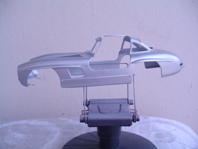

The color base coat was also custom mix. I mix 5:1 ratio of Humbrol metallic with Model Masters Gloss Gull Gray. After studying again the finishers catalog, I saw that also metallics can have a brown base that I guess could be closer to the final silver of this Mercedes that typically has an amber tint finish. It's real rare the use of enamels by me as a base on a body, but, this time I did an exception. I always prefer lacquers, but, I already had these colors. The only difference was the way I thinn them. Since I prefer lacquers because it's real fast time drying time, and because it's thinn consistency, I thinn my custom mix with PPG lacquer mid-temp thinner. Unlike when you use the Testors enamel thinner, in about 10-15 minutes the body was ready for handing, something you can't take the risk when you use enamels.
The body after the custom silver coats.
http://i7.photobucket.com/albums/y288/Porsnatic/Picture153.jpg
http://i7.photobucket.com/albums/y288/Porsnatic/Picture154.jpg
http://i7.photobucket.com/albums/y288/Porsnatic/Picture155.jpg
http://i7.photobucket.com/albums/y288/Porsnatic/Picture157.jpg
After a couple of days for drying time, I clear coated the model with PPG urethane clear. This was the one I could use for this job because this model almost has a complete rounded shape, and you guys knows that when you shoot paint or clear to any ronuded shape on a model, the gloss you obtain in that part it's perfect. Using this as a rule of thumb, I though after I clear coat the model with this I won't have to sand or polish anything else and that's the way it was.
Here you can see the results.
http://i7.photobucket.com/albums/y288/Porsnatic/Picture475.jpg
http://i7.photobucket.com/albums/y288/Porsnatic/Picture476.jpg
http://i7.photobucket.com/albums/y288/Porsnatic/Picture477.jpg
http://i7.photobucket.com/albums/y288/Porsnatic/Picture479.jpg

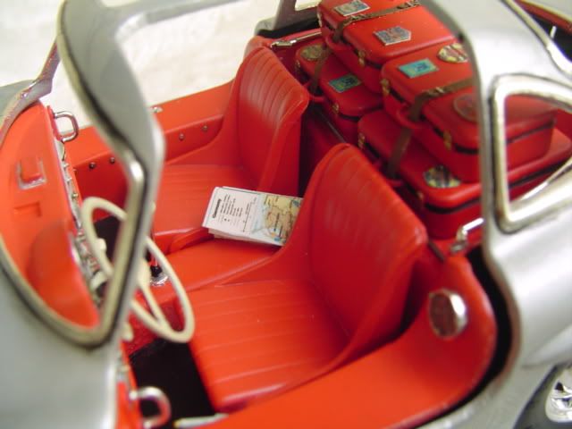

Let's go to the inside!
While the body clear coats dries for a few days, I'll go to the inside tub. First, I will post some interior pictures of the real car from were I will start on. Like you guys can see, this is truly special car indeed. This dash it's real impresive with all that chrome all over.
http://i7.photobucket.com/albums/y288/Porsnatic/Interiores7.jpg
http://i7.photobucket.com/albums/y288/Porsnatic/dscn1832.jpg
I started first selecting this red color for the interior. The reason was some pictures I saw of it in some books, that I actually like the contrast with the Gull gray metallic, and beceuse this one was one of the original combos on the actual car. For this color, I chose Bright Red from Finishers. A red that it's almost the sameas the Porsche's guard red color. This was flated a little bit with some Model Masters Acrylic semi-gloss clear. I was lucky that I have the testor red flocking that match perfectly with it.
http://i7.photobucket.com/albums/y288/Porsnatic/Picture107.jpg
Everything it's being prepared for red-black of the carpets color separation as you can see in the pictures below the interior tub.
http://i7.photobucket.com/albums/y288/Porsnatic/Picture116.jpg
After I painted the tub, I start to add some details that will match the real car. There is a little bar where the luggage belts will wrap. This was made out of some piano wire across the tub.
http://i7.photobucket.com/albums/y288/Porsnatic/GWCC11.jpg
Here it's a picture of the real dash and how it will have to be detailed.
http://i7.photobucket.com/albums/y288/Porsnatic/DSC04842.jpg
After the dash, seats, and added the steering wheel and the shift stick; this is the way how it's look until now.
http://i7.photobucket.com/albums/y288/Porsnatic/Picture143.jpg
http://i7.photobucket.com/albums/y288/Porsnatic/Picture146.jpg
Here there is another detail not to be missed...the interior side speakers.
http://i7.photobucket.com/albums/y288/Porsnatic/JUDD177.jpg
Like I told at the beginning, I had an original Heller kit that I messed up. From that kit I took the speakers...
http://i7.photobucket.com/albums/y288/Porsnatic/Picture137.jpg
But..there is something still to add...the speakers grill. I got'em from the detail master speaker detail set. A real nice touch!...it will be later completed with some tiny bolts from the Model Car Garage nuts 609 Bolt head details set.
http://i7.photobucket.com/albums/y288/Porsnatic/Picture138.jpg
Fom the Aston Martin DB4 Revell kit, I got the luggage set. Real differet from the one that came with the Gullwing, but,...it's the only one in hand at the moment since it's real hard to get one likt that.
http://i7.photobucket.com/albums/y288/Porsnatic/Maletas.jpg
Here is how I finished it. I will add some other detail to them later.
http://i7.photobucket.com/albums/y288/Porsnatic/Picture158.jpg
Here it's a mock up how it will look when completed. Like you guys can see here, the engine it's already fitted, but I remeved it to do the detailing, and that ovbiously will be another chapter.
http://i7.photobucket.com/albums/y288/Porsnatic/Picture181-1.jpg
http://i7.photobucket.com/albums/y288/Porsnatic/Picture188.jpg
to be continued!!!!
