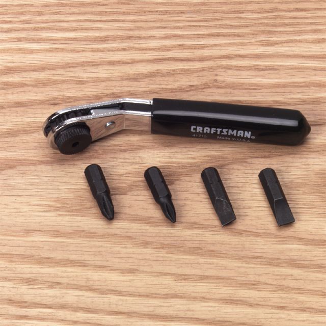

mcqueary
03-26-2006, 01:20 AM
An offset ratcheting screwdriver from Sears allowed me to remove and replace the TPS on my 93. I agree the design could have been more user friendly.

I have the straight, not offsetting screwdriver, it won't fit. I'm going to try a manual, home lockset offsetting screwdriver, hopefully that works.
http://s7.sears.com/is/image/Sears/00941715000?layer=comp&wid=190&hei=190&fmt=jpeg&qlt=75,0&op
