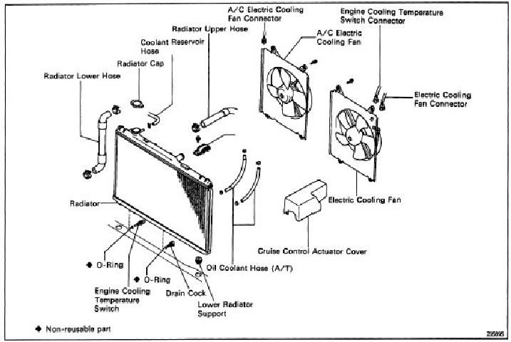

My 92 camry sedan has 178*** miles on it. Recently the car has overheated 3 times. I believe that the problem is with the fans. They dont want to turn on at idle or low speeds, > 20 mph. I was going to completely replace the entire cooling system, water pump, thermostat, radiator hoses.. ect.. but I believe that the fan motor or fan switch may be broken. I think the switch is the one that is broken because the fans kick back on at speed, <20mph. And when they kick on the car's temperature returns to normal operating temp. Where is the fan switch on the car, and how can I check and see if that is what needs to be replaced. I would much rather replace the fan switch than do the entire system. I know the car is old and I might need to replace the other components soon anyways, but if I can save some money, that would be great. Thanks for your help

http://i16.photobucket.com/albums/b8/rogersb/Radiator.jpg
For additional information see page EG1-251 in the Camry manual in the sticky post at the top of the Camry forum.
