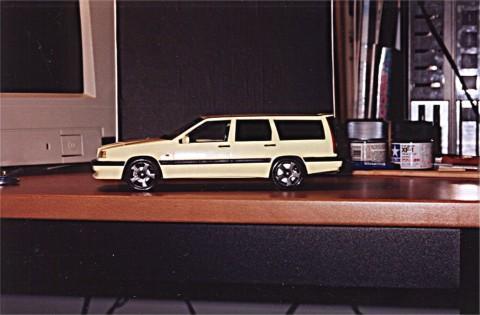

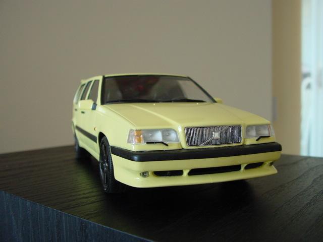

Someone offered me... lets just say large enough amount of money for me to build them an EXACT model of their car: a yellow Volvo T-5R Limited.
This car itself does not have a model, but Tamiya did make a Volvo 850 Wagon, which was what I used as a base.

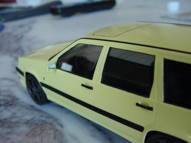

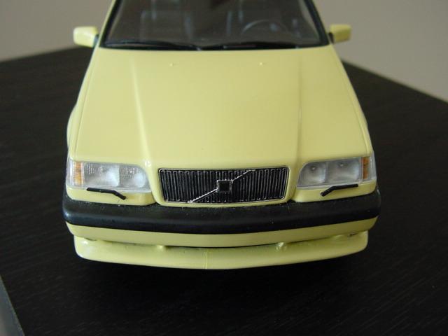

A front lip was made by hand with Tamiya Putty, and a sunroof was carved out on the top of the roof. The body was pretty much then finished after that... not much work there.

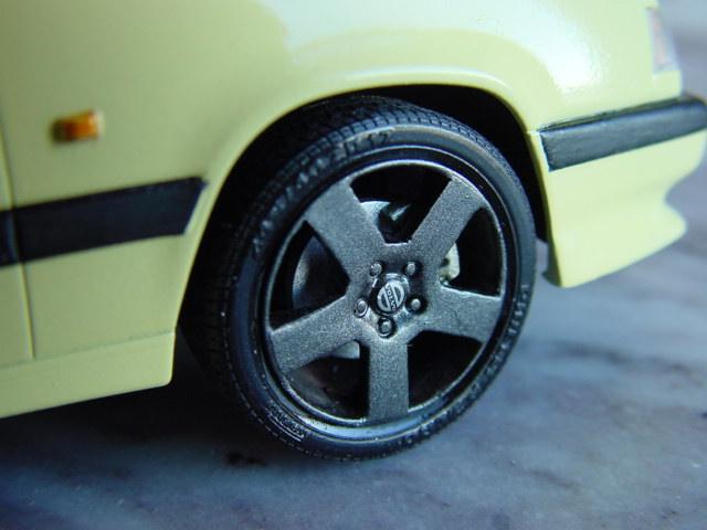

The time consuming part was the 17" 5 spoke wheels that ONLY came in that T-5R. I had to go out and buy a set of 1/24 17" Fujimi 5-spoke rims, totally cut them up and re-do the entire thing with putty until it looked exactly like the ones on the real car. (Luckly Fujimi rims sets usually comes with Pirelli P-Zero tires, which was what the real T-5R was equipped with).
Then the next trouble was to match the paint. I went out and bought a bottle of touch up paint from Volvo for that car and sat there for a day trying to match it with Tamiya colors. It worked out great after 4 hrs or so of mix and match.
A set of front headlight wipers was stolen from a Tamiya Benz S500 Coupe to accomidate the Volvo (but it was not put not yet at the time these pictures was taken).

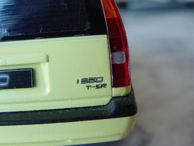

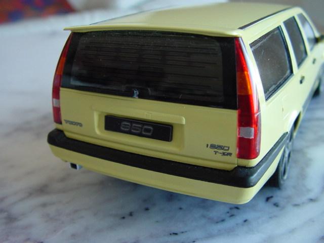

And finally, I took the decals that came with the kit and managed to cut it up and make the emblem at the rear that says "T-5R."
Window tints were also added for the real car had some.
Updated pics:
Back
